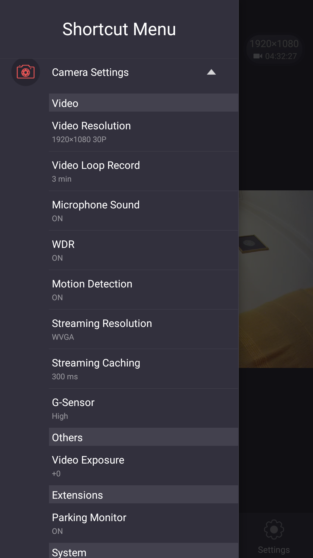

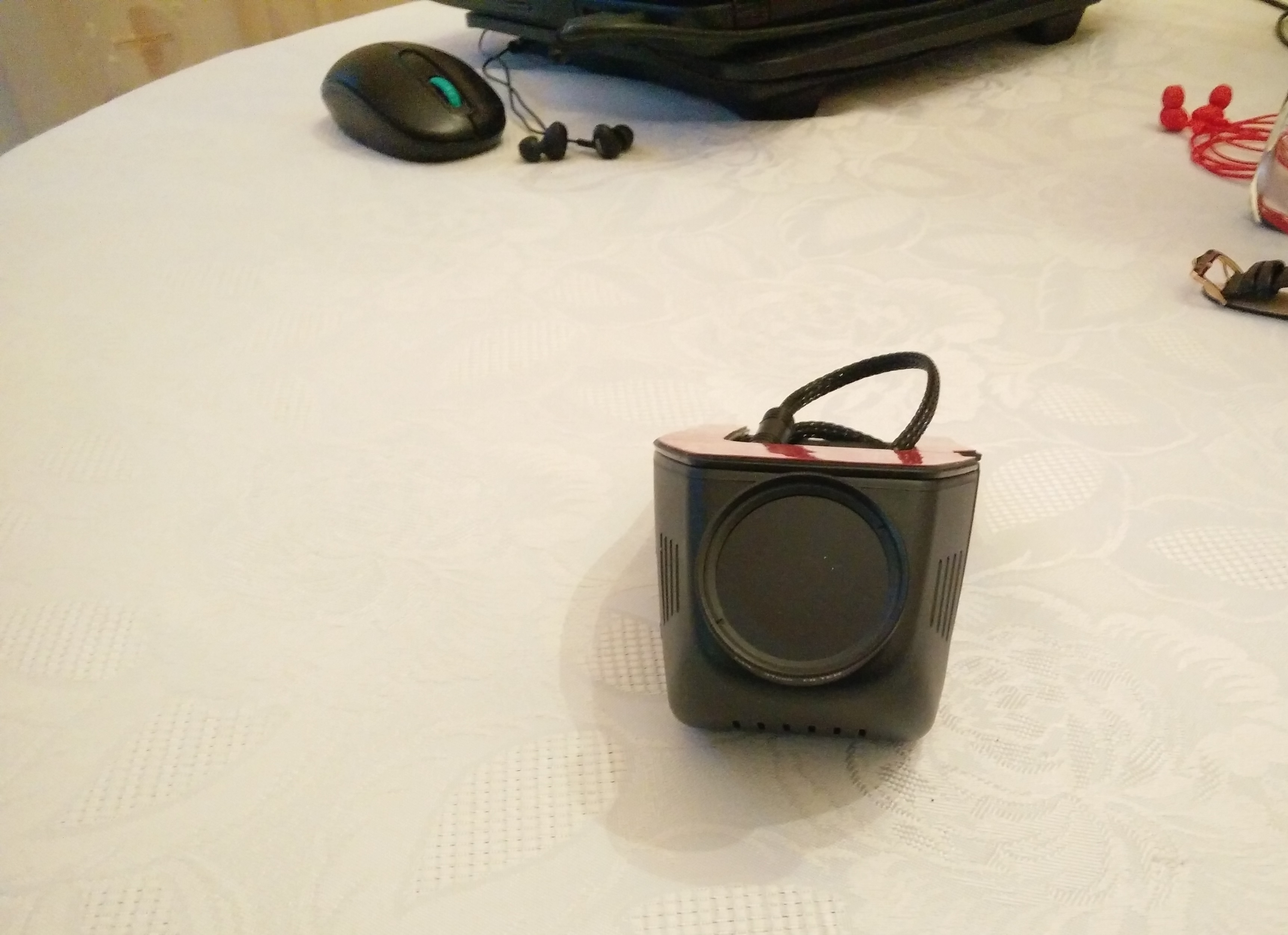

  2. Hi guys from Greece,i found usefull information to your site.
    Yesterday i install the dvr,is with imx 323 sensor and firmware CARDV_IMX322/3_2059_20161013V1059.
    Parking mode is contrled by gsensor,if dvr is off and parking mode on when you knock front glass starts recording for one minute.I believe if gsensor set to high then you must knock hard to awake.
    Motion sensor is working if dvr is on and not recording,my wifi is always on and when not phone is connected,i have to turn it off manually.
    I thought that i'll have redio interference because the antenna front but there is no,i'll check the next days.

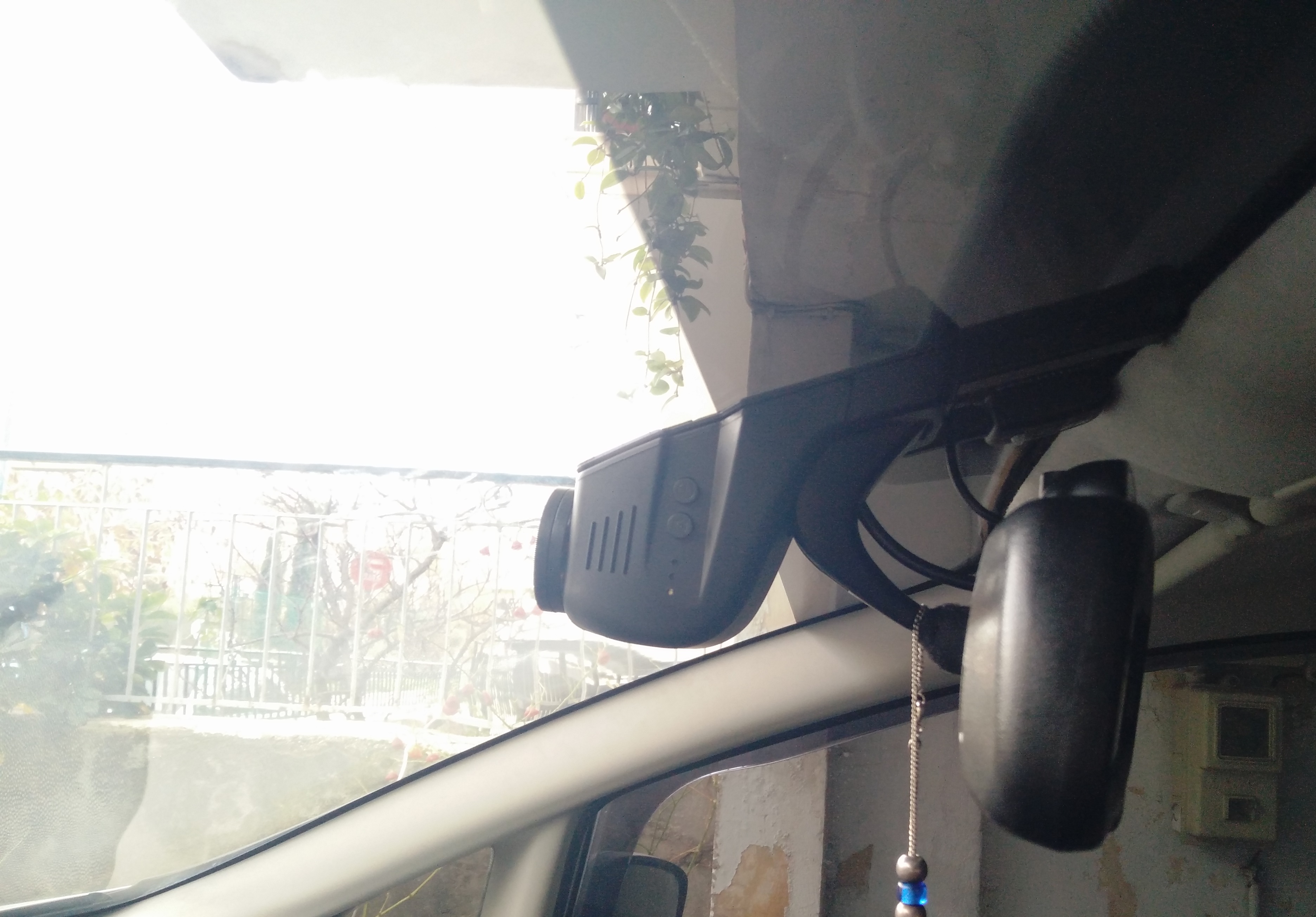

    I have bought that cpl filter and have cut the back frame so i can stick it close to the lens.The frame can seen only a little at up left corner(i don't know why only to that spot was visible) https://www.aliexpress.com/item/Sup...32581635844.html?spm=2114.13010608.0.0.j4afUe

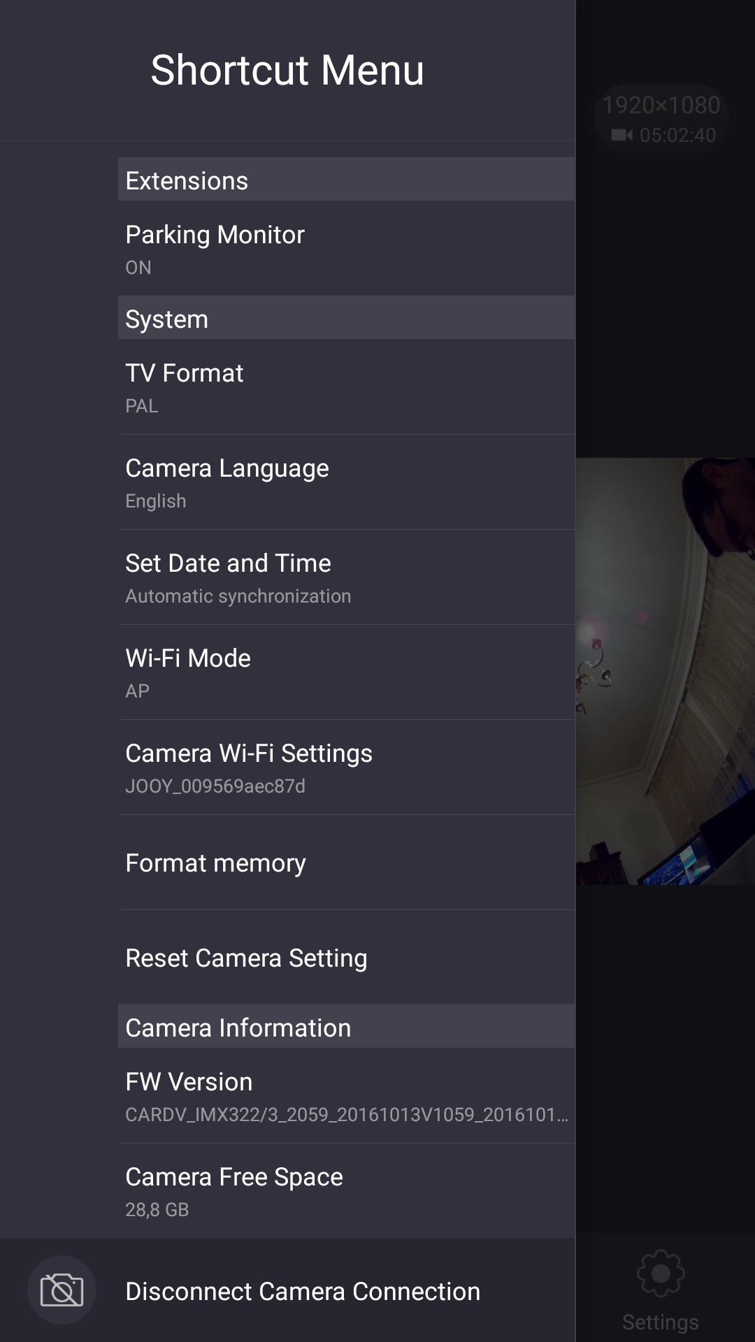

  3. Ну, значит модель проапгрейдили. Я купил в конце декабря. У меня молчит и пикать ему там нечем. Хотя, я сам бы не против был бы, если бы он пикал что начал писать. Светодиоды нефига не информотивно мигают. Они всё время в режиме WI-FI у меня, то есть синим мигают
  4. Good day.
    Today I found the receptionist. Firmware version is the same as you.
    With the features of each function is not yet understood. In this Your information is useful.
    I then did not understand how to turn off Wi-FI. A short press on the power button only forces the disconnect device, but does not disable the Wi-FI. I constantly blinking blue LED. Or, often, when one is not connected, or rarely, if connect by Wi-FI.
    It is unclear if Gsensor off, shall operate parking monitoring mode?
    Again, it is not clear purpose motion detection mode, if the DVR forced himself begins recording after switching on. If motion recording begins only if the record had not conducted, it turns out, someone had to stop her.
    Well Gsensor levels of sensitivity, it is not clear, for example, Low mode, this low sensitivity, or is sensitive to weak shocks?

  6. I have a rearview mirror with lcd monitor and connect dvr there.
    When the dvr is recording if you press power button twice the wifi stops,if you long press the dvr shut down.Check it while you have connect your phone to understand the operation.The blue led blinking means that the dvr is recording,if only red led blinking the dvr is on,not recording,no wifi connect.
    If you set gsensor off the parking mode doesnt operate,if you set it at low then means that the dvr can
    understand and the weak shocks.
    Motion detection me either don't know how works,i think when test it records for three minutes.Maybe the operation is if you have off the car and you press power button to the dvr to set it to stand by mode and writes clips if there is detection infront.
    Or if the parking mode is triggered(because in this mode writes only for one minute)if it's sense motion detection keeps writes longer clips

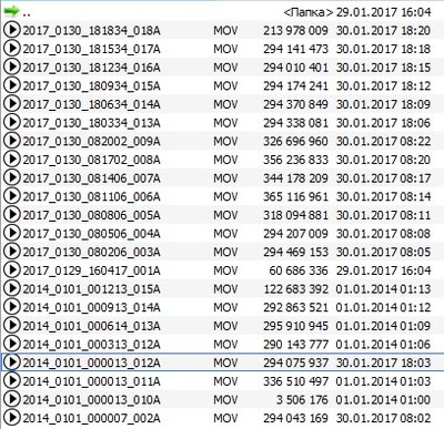

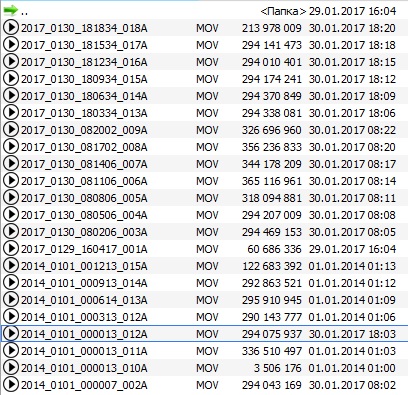

  14. Всем привет! Купил я себе такой ВР и я заметил что сегодня пока грел авто решил посмотреть как пишеться, все норм дата 30.01.2017 ну норм и поехал, по пути на работу заехал в транспртную, а за тем на работу! день машина стояла не ездила, далее в 18 часов я поехал домой проверять ничего не стал, приехал домой, вытащил флеху посмотреть как пишет и вообще порядок видео на компе! Вставив флешку увидел разные даты. Сначала он записывал как и полагалось 30.01.2017 а потом несколько роликов 01.01.2014 , а потом снова 30.01.2017 и вечером есть тоже видео смешаное.
    Ниже прикреплю фотку там по времени справа видно в какое время как писалось видео! В чем может быть причина?

    Возможно пропадает или низкое питание на + В, например при включении стартера. У меня такое было, закономерности пока не нашел.
